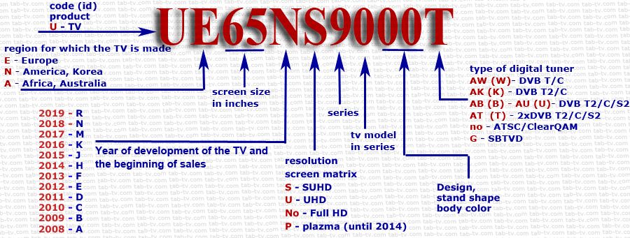

    UE55F8000AFXZ
    Tableau récapitulatif des codes de modèle depuis 2008
    Détails de la référence en exemple
    Signification
    U
    U = LED
    Q = QLED
    P = Plasma
    L = LCD
    H = DLP
    K = OLED
    E
    N = Amérique du Nord
    E = Europe
    A = Asie
    55 =  Diagonale de l’écran en pouces
    F  =  Série / Année de Fabrication
    T (2020) U (UHD)
    LS = TV Lifestyle
    LST7T = The Terrace 2020
    LS05T = The Sero 2020
    LS03T = The Frame 2020
    LS01T = The Serif 2020
    LS01R = Serif TV 2019
    LS03R = The Frame 2019
    LS03N = The Frame 2018
    LS003 = The Frame 2017
    LS001 = Serif TV 2015
    Q = QLED
    Q***T = 2020 8K QLED
    Q**T = 2020 UHD QLED
    Q950R = 2019 8K QLED
    Q**R = 2019 UHD QLED
    Q900R = 2018 8K QLED
    Q9FN = 2018 Back Lit UHD QLED
    Q8DN = 2018 Back Lit Plat UHD QLED
    Q*CN = 2018 Edge Lit Incurvé UHD QLED
    Q*FN = 2018 Edge Lit Plat UHD QLED
    Q*CAM = 2017 Incurvé QLED
    Q*FAM = 2017 Plat QLED
    * Valeur numérique
    Full HD, UHD et S-UHD
    TU = 2020 UHD
    T = 2020 FHD
    RU = 2019 UHD
    R = 2019 FHD
    NU = 2018 UHD
    N = 2018 FHD
    MU = 2017 UHD
    M = 2017 HD
    KS = 2016 SUHD
    KU = 2016 UHD
    K = 2016
    JS = 2015 SUHD
    JU = 2015 UHD
    J = 2015
    HU = 2014 UHD
    H = 2014
    F = 2013
    E = 2012
    D = 2011
    C = 2010
    B = 2009
    A = 2008
    8000   Désignation des séries
    A      Fonction ou design
    FXZ   Informations de production
